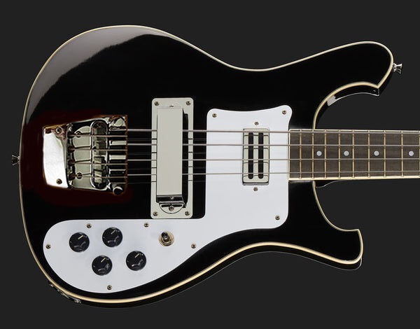

Here is the standard Ric-a-like bridge fitted to a 34" scale length Harley Benton.

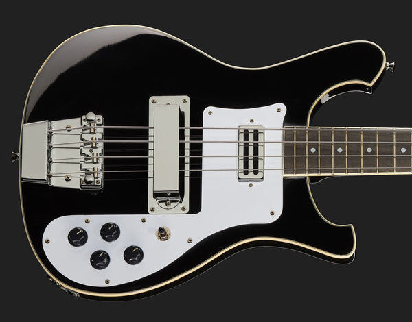

And here we have a Ric bridge placed for 34" scale length.

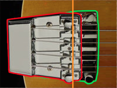

Your photoshopped Rickenbacker bridge is a bit deceiving, as it isn't the right size, which becomes becomes quite evident when following the string paths.
Admittedly the perspective is not the same, but if you flip it upside down and position it by the center of the strings to match the spacing of the HB's bridge, it is close to the size of the HB's bridge and much closer towards the neck.
I do have that exact bridge and it won't fit on my bass, because the saddles points are further towards the front on the HB's bridge, pretty much in the place where the Rickenbacker bridge has its mutes.
My 34" Rickenbacker copy, just has a longer scale neck and the same size body as a normal Rickenbacker 4003, this bridge would have to move further back and over the edge of the body so it protrudes by about 2 cm to acchieve the correct scale length.
This is the difference in positioning that would be necessary, so on my bass it would look like this - the orange line roughly shows is the 34" scale length, green is the original bridge positining and red the HB-Style bridge:
The point of the graphic is to show how far forward the Ric saddles force the bridge to sit.
That is what the photo shows . The pictured bass was 864mm scale length so the saddles for both bridges were placed in the correct positions .
The faker bridges are 98.5mm long x 92.5mm wide. Rickenbacker bridges are 101mm long x 98mm wide.
There is roughly 30mm from the front of a Ric bridge to the saddles. Does your kit have 70mm of body left behind the saddles ?
