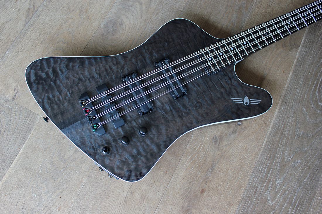

Ein neunen Brooks Bass ist geboren.

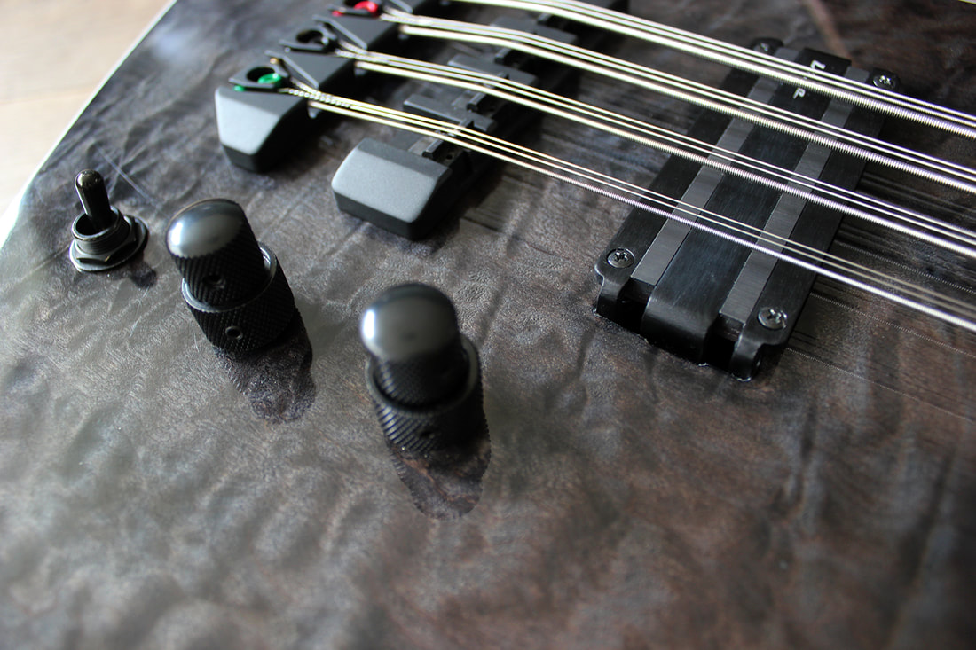

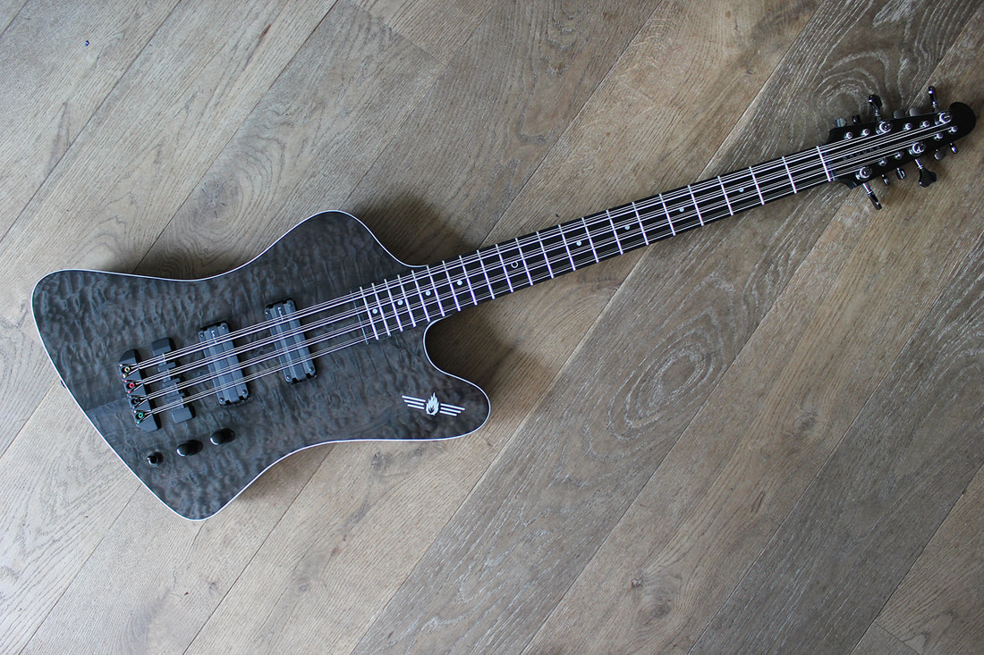

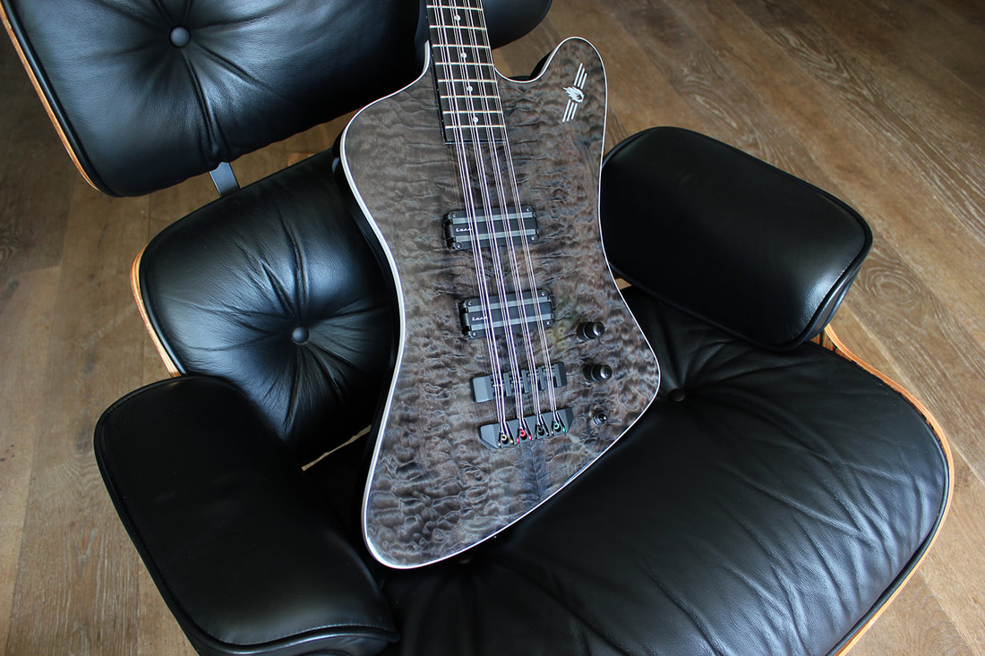

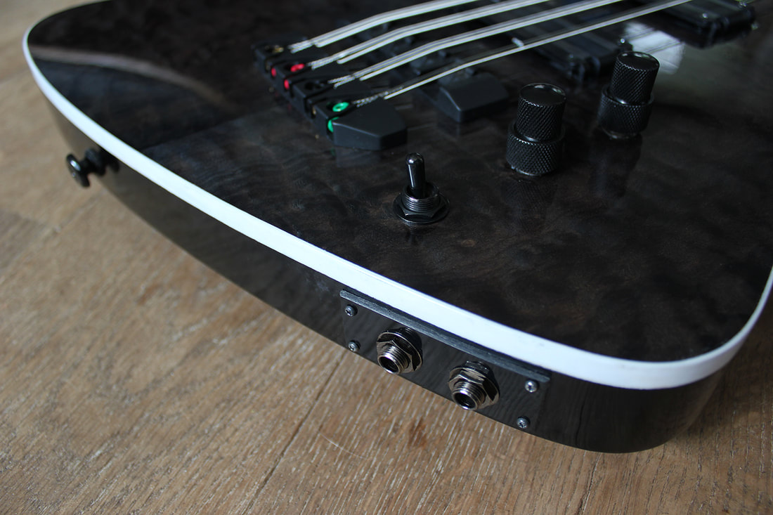

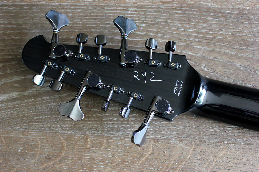

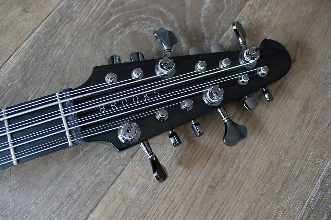

TB-12-Q
Zwölfsaiter Thunderbird Bass mit Quilted Maple Top.
- Mahogany body
- Bookmatched Quilted Maple top
- Nine ply Mahogany/Walnut set neck. Glued in
- Transparent black stain
- High gloss transparent acrylic finish
- White binding
- Ebony fretboard
- Mother of pearl position dots
- Jumbo frets
- 34" scale
- Buffalo horn nut
- ETS twelve string brass bridge set
- Two spokewheel double action trussrods
- Carbon reinforcement strip in the neck
- Lace Alumitone Bass Bar in the neck position
- Lace Alumitone DeathBar in the bridge position
- Allparts stacked pots (volume/tone volume/tone)
- Mullard capacitors
- MEC on-on switch for coil split (humbucker-single coil)
- Gotoh GB 350 lightweight bass tuners
- Gotoh Stealth ST 31 guitar tuners
- 2 xPure Tone Multi Contact jack output
- d'Addario EXL 170 - 12 strings
- Weight: 4.25 kg
Electronics circuit by Bas Becu.
Serialnumber: 2021003
