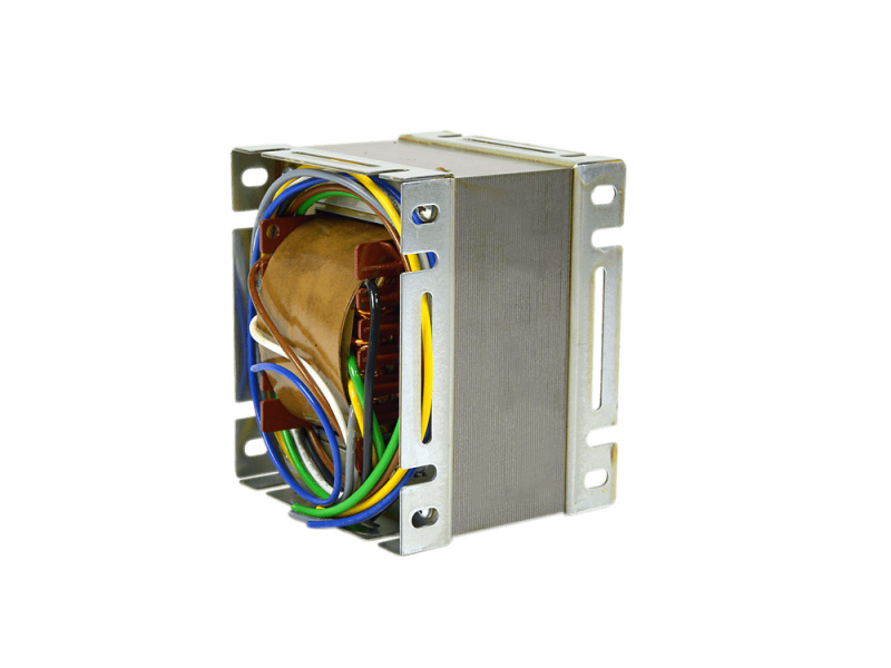

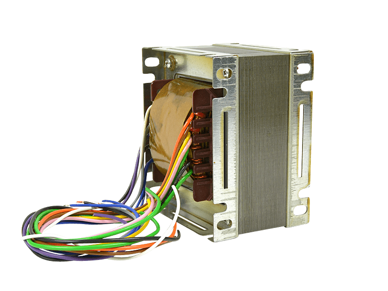

That are the specs of the Tube Town power tranny:
Reaktionen: quarkfrosch

So... I got the big one from Tube Town (https://www.tubetown.net/ttstore/de/tt-dr405-hiwatt-style-netztransformator.html).
It works. I rewired the heating for 6,3VAC. The good thing is that apart from that, there is no need to mod the bias circuit. I needed to cut a bit of the wood support for the back (it does not show with the back in place) and mount the transfo on its long side (as shown on tube town but rotated 90 degrees). The only way to install it so that it fits.
Works fine. I have a slightly lower voltage (625) than before (640) - on 227VAC mains. No big deal, I biased the tubes at 75% of 35W.
And now it weights 27,7 kgs. Lovely.
Cheers!
