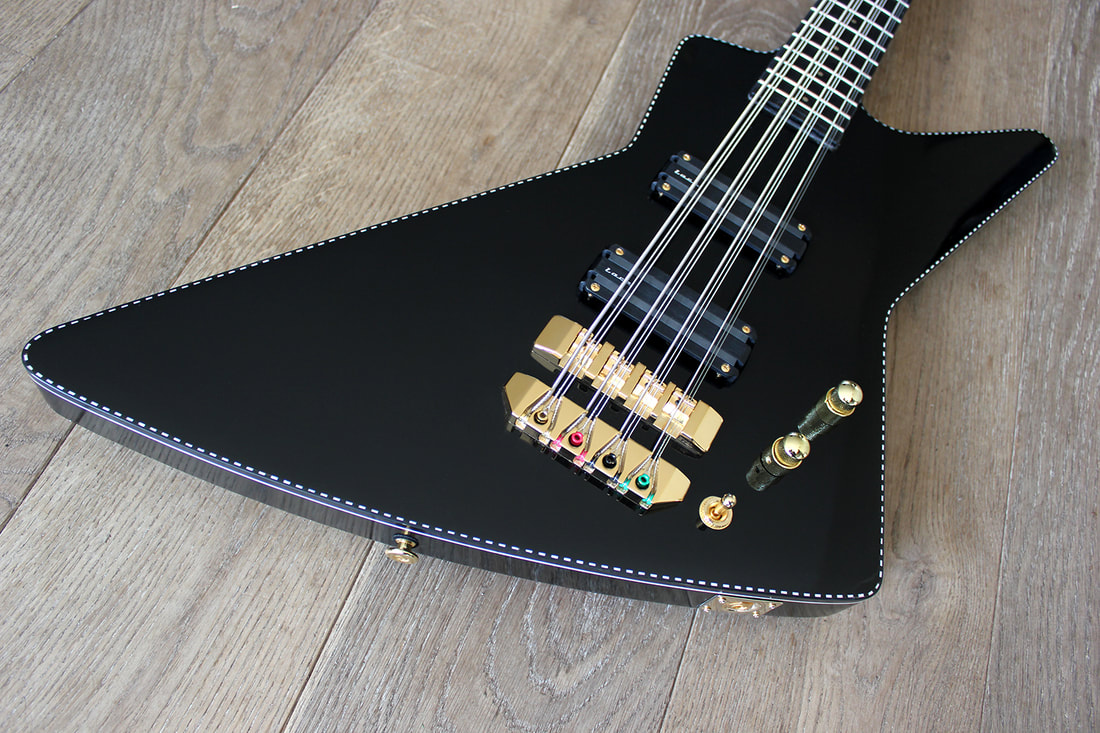

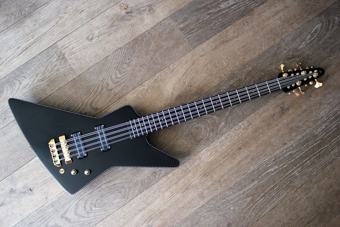

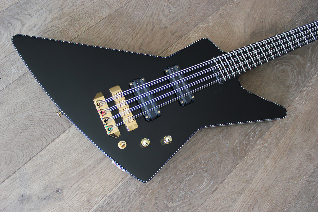

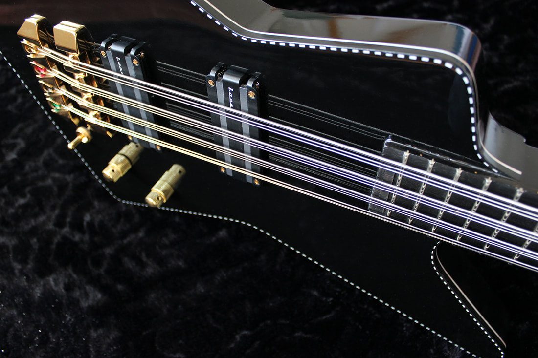

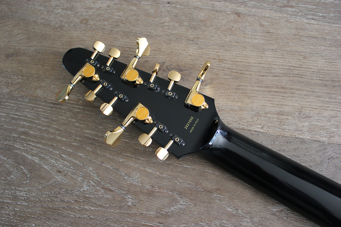

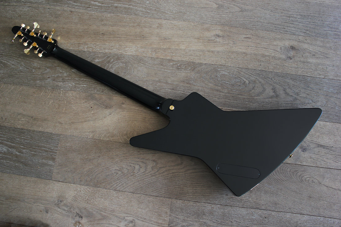

Ich habe wieder ein neuen Bass gebaut.
Brooks EXB-12-2PR (EXplorerBass - 12 string -2 pickups Reverse triplets).
- Mahogany body

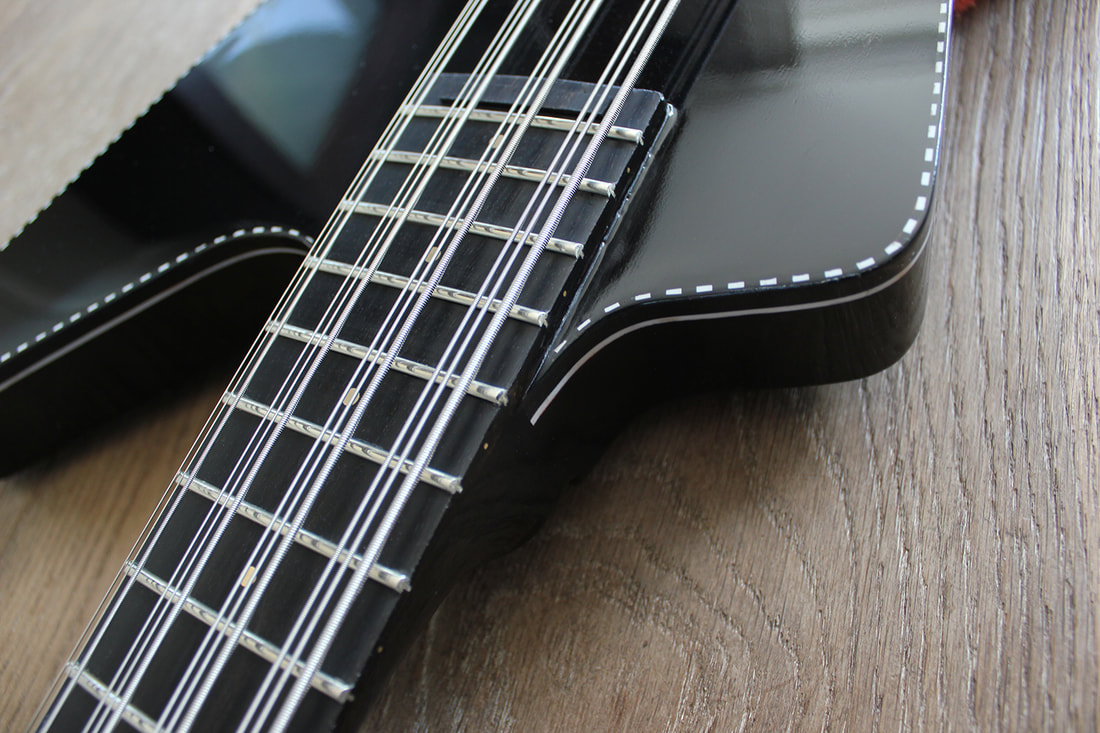

- Laminated Mahogany set neck. Glued in
- Black gloss finish
- Checkerboard binding
- Ebony fretboard
- Brass position dots
- Nickel silver frets
- 34" scale
- Buffalo horn nut

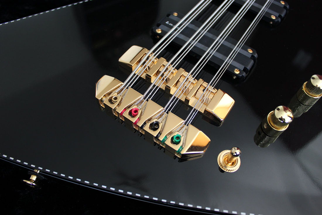

- ETS twelve string brass bridge set. Gold plated
- Two spokewheel double action trussrods
- Carbon reinforcement strip in the neck
- Lace Alumitone Bass Bar in the neck position
- Lace Alumitone Bass Bar in the bridge position
- Switchcraft output. Gold plated
- 2 x Stacked volume/tone knob. Gold plated
- Pickup selector switch. Gold plated

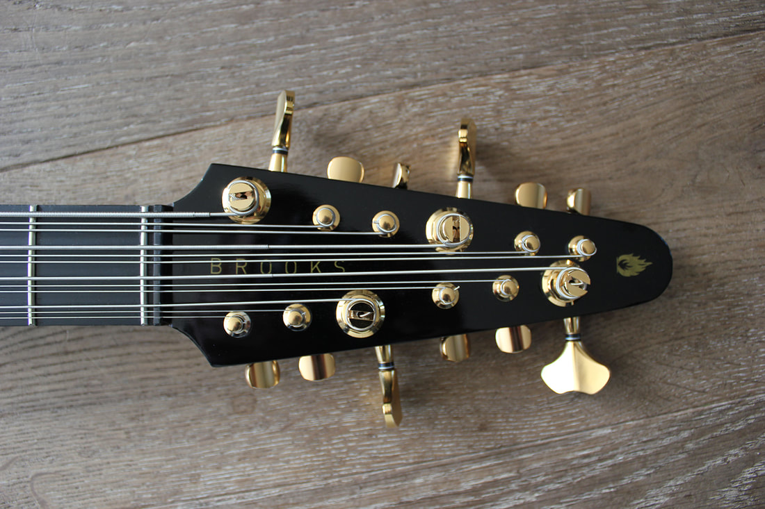

- Gotoh GB 350 lightweight bass tuners. Gold plated
- Gotoh Stealth ST 31 guitar tuners. Gold plated
- d'Addario EXL 170 - 12 strings
- Weight: 4.5 kg
Electronics circuit by Bas Becu.
